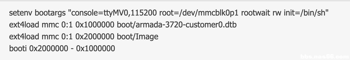

首先进shell:(坛子还不给上传代码,自己敲部分代码贴Google就能找到了)
& Y" r- c. T/ C) H4 a C6A5CC68-9AE4-4097-B786-E6B5CFE0FE8D.png . G, P) o  j# A5 [  g! P
- a: \& x9 E+ f2 }  g( ^. b然后重写emmc,可以参考板块里猫盘一键刷群辉命令脚本重写full.bin,我是下载到U盘然后sh执行,修改成本地路径不走github,太慢。' Z  z  v& z9 v5 M+ G0 o
这样重启以后,能获取到ip。

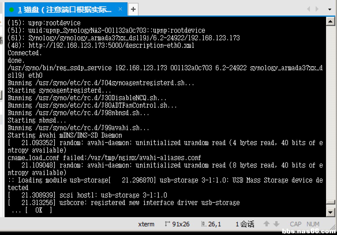

, s7 X  W0 N$ j4 E. @请教高手能否详细说一下,怎么操作,我刷机后就一直无法分配ip
( u+ G7 K5 b+ f4 @2 z:: Starting syslogd ... [  OK  ]5 e9 L% `$ v( y+ n( V0 H% C
/etc/rc: line 273: /usr/syno/bin/syno_pstore_collect: not found" H0 ?9 q% ^: @- ~) ^7 ?( z
:: Starting scemd
& i8 F. n7 ~/ b* B/ N; p( e# y0 n[   15.265002] mvneta d0030000.ethernet eth0: Link is Up - 100Mbps/Full - flow control off4 }; h/ V* z: ?, z
:: Starting services in background
& o$ h, g5 v7 CStarting findhostd in flash_rd...3 s+ f% u% \; N0 T0 V$ l) u
Starting services in flash_rd.../ g4 W- M/ o% n7 N/ D$ |
Running /usr/syno/etc/rc.d/J01httpd.sh...
* z0 I3 g1 c3 w7 PStarting httpd:80 in flash_rd...$ a; a, \6 Y/ I2 s# M% L
Starting httpd:5000 in flash_rd...: l5 A7 u7 Z3 P# D: q6 x5 h
Running /usr/syno/etc/rc.d/J03ssdpd.sh...
+ I5 m5 A7 e) v. ?8 f  x/ |$ d' ~/usr/bin/minissdpd -i eth0
' G* _6 t$ }4 z$ {/ k$ ]" Q6 H, h(15): upnp:rootdevice/ [, ?/ b( e. {' ~+ O! a& H9 n- q
(51): uuid:upnp_SynologyNAS-001132a0c703::upnp:rootdevice0 O! q  o0 q* b) Z+ o. L
(60): Synology/synology_armada37xx_ds119j/6.2-24922/169.254.16.201
5 `- a% I, N4 K7 j(47): http://169.254.16.201:5000/description-eth0.xml1 U7 G, y# k5 Z$ ^& o. E) D$ V5 q/ r; ?
Connected.
  Q7 t/ D. {5 R1 Ldone.$ x; v0 h0 i. `& X& k6 m+ F
/usr/syno/bin/reg_ssdp_service 169.254.16.201 001132a0c703 6.2-24922 synology_armada37xx_ds119j eth0! L2 A. s- |6 r9 f# @0 f% w
Running /usr/syno/etc/rc.d/J04synoagentregisterd.sh...) e# n4 u. f. T+ s
Starting synoagentregisterd...( i& i$ H1 ^$ I' |
Running /usr/syno/etc/rc.d/J30DisableNCQ.sh...
7 Z' v9 \# p4 ?3 x; ^0 C% TRunning /usr/syno/etc/rc.d/J80ADTFanControl.sh...
  R" @  u' P& v5 c: aRunning /usr/syno/etc/rc.d/J98nbnsd.sh...
5 t  `& j3 W( y8 S1 D/ ?Starting nbnsd...
: K2 g) Y# ~: qRunning /usr/syno/etc/rc.d/J99avahi.sh...$ f# k' H. G+ e( k/ P0 d( a
Starting Avahi mDNS/DNS-SD Daemon
$ v6 u# A+ }2 Z) V4 `2 u6 _, t[   21.533652] random: avahi-daemon: uninitialized urandom read (4 bytes read, 100 bits of entropy available)9 L# q. N, x9 o) Y
cname_load_conf failed:/var/tmp/nginx/avahi-aliases.conf
) ]3 ^! d% }, e8 F2 J[   21.549276] random: avahi-daemon: uninitialized urandom read (8 bytes read, 100 bits of entropy available)
" q$ R6 f$ r% G$ x- `5 o! x, J[   21.598391] random: sfdisk: uninitialized urandom read (16 bytes read, 104 bits of entropy available)
* K3 }0 ^- u3 w' [7 D3 K[   21.610860] random: sfdisk: uninitialized urandom read (16 bytes read, 105 bits of entropy available)
3 i# E7 S; q) a( Q) g
